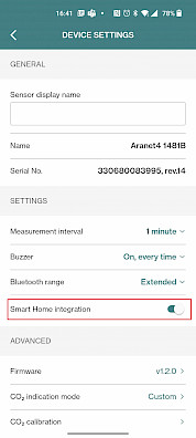

  1. Before starting to use integration, please configure the Aranet4 device using the Aranet Home App - enable Smart Home Integration in the Aranet Home App device settings

Aranet4 is using BLE (Bluetooth Low Energy) communication protocol, which has a limited range. Please ensure a close distance between Aranet4 and the Home Assistant device to avoid connectivity issues. To improve connectivity, you can select the Extended Bluetooth range option in the Aranet Home App device settings.
