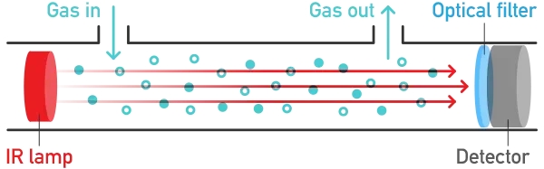

chevron-rightWhat is the NDIR sensor and why is it preferred over other types of sensors?hashtag
Aranet4 uses a non-dispersive infrared (NDIR) sensor to measure CO2 levels. The device features a small gas chamber with an infrared light source, where CO2 absorbs the light. An optical filter in front of the detector then filters out all light except the wavelength absorbable by CO2 molecules, enabling a precise CO2 concentration level measurement. This CO2 reading method offers higher precision than regular electro-chemical sensors, as it uniquely detects carbon dioxide with no interference from other gases. Furthermore, the NDIR sensor has a much longer lifespan and requires less recalibration than other sensors.
